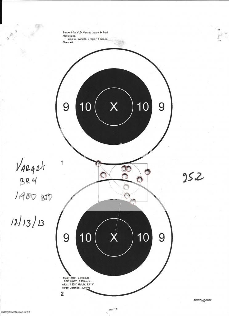

Finally was able to get to the range today and being the curious person that I am I wanted to see if y'alls predictions on my loads with the high ES would hold up. Shooting at 300 yds the highest ES load did open up but not as much as I expected. I'm going to shoot the same loads at 600 and 800 when I get the chance (hopefully next week) and see what happens. What do y'all think? Am I chasing my tail here?
