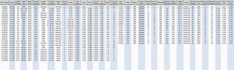

Out of curiosity, I'm about to test a suggested powder I've heard about but not ever seen used in a 6.5 PRC. Here's how I collect data on my reloading:
