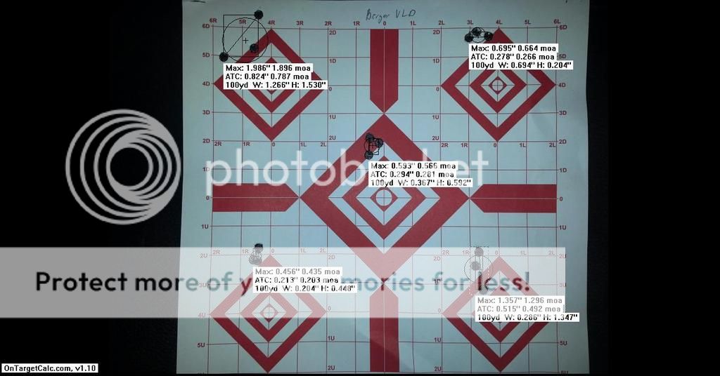

here is a target from my .308 hunting rifle. final seating depth test with 44gr varget and berger 168 hunting vld's. jumping .130 from jam. each of these targets were .010 deeper seated
