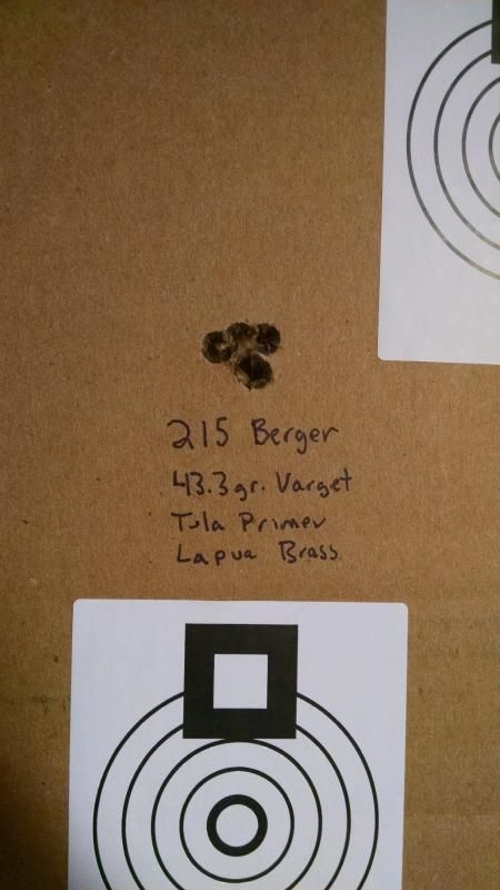

I'm seated 20thou off lands with my varget load and they are running at 2672fps
Good luck with your load development!
100 yards ,5 shots. It basically took me a year behind the rifle to get my technique and handling skills good enough. We will see how I do this year using these for a whole weekend. I am not sensitive to recoil, but I did have a bruise after a day of practicing with these and a firm hold. That makes the second day rough.
This load of Varget may not be safe for you!
