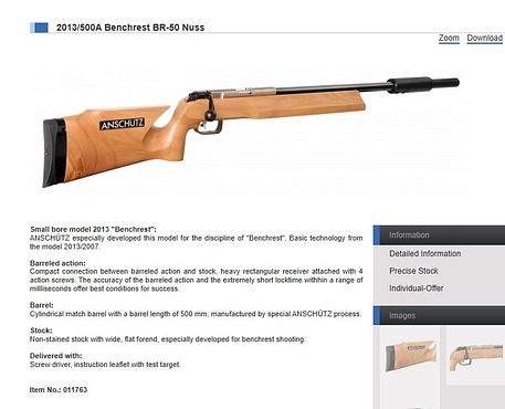

Anschutz at some point had a specific Anschutz BR 50 model with the 500 mm barrel and barrel weight/extension. (see below)

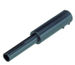

The barrel weight/extension has dovetails for mounting a front globe. It is fixed and non-adjustable. (See the image below the rifles.) Anschutz also made a very similar but longer barrel weight/extension as well as one that's made to fit the larger muzzle diameter of the 1913 and 2013 barrels.
[/URL]
This, I believe came a few years later. The 2007 barreled actions that came here had no provisions for stocks here or home market for a few years, then the BR50’s made an appearance.
The “tuner” on these, I never saw on anything else here or EU…..everything after was a version similar to your pictures, a longer bloop with dovetails.

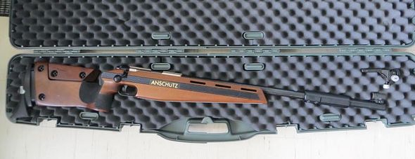

I have included a few pictures of the CM action in case any are interested.
The short barrel / extension tube offered was kind of revolutionary for its time. I believe tuners and extensions were around pre-1985 in many forms, but not offered from a manufacturer that I can remember. The AMU did a significant amount of testing around the extension tube Anschutz provided - mostly playing with torque values on the clamping screws. I remember Mike Anti telling me they were using 6nm (which was a lot of torque for threads in aluminum), which many were using. I don't believe we prone shooters were manipulating the mass along the barrel's axis (per todays tuners) - but the additional torque did seem to improve performance (either through muzzle constriction, or some variable involving the rigidity of the connection, IDK).
