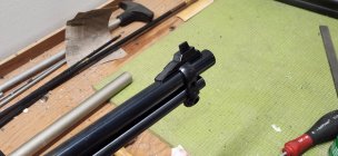

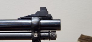

I despise those one piece "barrel band and front sight" combinations.
This was my solution; mill a dovetail slot in it and install a REAL sight.
