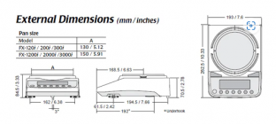

So I decided to get the scale on a piece of hard board. With the board on my bench and the scale on it, I leveled the scale. Drew lines on my bench as a reference and tied the scale to that board.
So when I pull it out next time I will line up to the lines and the scale is leveled and ready to go. However, this setup is only good for this position. I guess I can get some adjusting bolts on the board then I can take it anywhere.

It took several tries to figure out how to level the AnD. The biggest take away is the legs does not level on a straight line.
Looking at the scale with on/off on the left and orange re-set on the right,
- Moving the right leg moves the bubble in \ this direction. After i figured it out I took smaller turns and was able to get it level much sooner.
- Starting with the legs fully extended seem to move the scale less, than starting fully retracted

I have done the dimples.
I don't understand why the unit doesn't have four leveling legs. It seems to me that would be easier.
If three non colinear points determine a plane, why are there not only three legs? :)
AS others have said, mark the location of the feet.
Adjust the level slightly......... then WAIT. The bubble moves very slowly.
Make another adjustment , .........then WAIT. allow the bubble time to move.
Make small adjustments.
