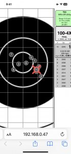

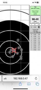

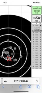

I shot two strings in competition on e-target two weeks ago that showed one ten shot string with SD of 9.6 and a 20 shot string with SD of 9.0 with a .223. My other strings that day were 12-15 SD. All of this at target not muzzle.
This was done with 4x fired brass, processed un bulk by MS processing. Trimmed and chamfered on a Giraud tri-way trimmer. 205mar primers using a RCBS hand primer, H4895 from a Chargemaster and sierra Match king 77 seconds. I did sort the SMK by base to ogive since they were seconds. No real meticulous prep.
