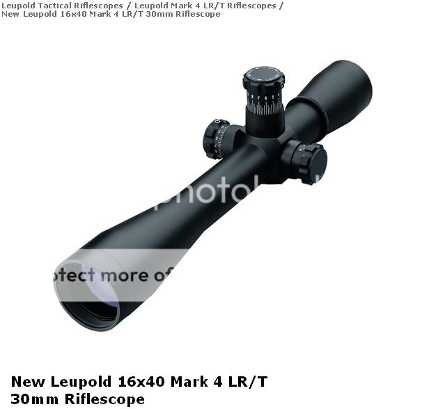

I sure like my Leupold 16x40mm LR/T M1 30mm scope part # 45581.
She's extremely clear and on a 100 yds zero, the scope is currently at 60 MOA from the bottom. There is 85.75 moa of up remaining, good in my case for a hair under 1900 yds.,Only need 24.5 moa for 1000 yds, still in the middle of the scopes adjustment) This is with Burris Zee rings with ZERO inserts sitting on 20 MOA Weaver modified bases. The way she sits, crank her all the way up till she stops, then down 1 full rev and your good for one mile! Total of 145.75 moa of vertical adjustment. Great scope IMO. With the fine cross hair and dot, you can still see the rings and hold inside the V bull at 1000 yds DCRA target easy. The turrets click easy so you can just set her up were you were aiming and click the cross hairs to the bullet hole, unlike some that are so stiff that you can't keep the rifle still on the target while clicking.
Some will say it's too low of magnification, but I've used a T6 at 1000 yds so this is more than enough mag IMO. You still see the mirage running and you can still see the target.
Ask Keith what scope he's shooting now on his 6/250 .......Nightforce. How about a photo and an up dated report Keith.

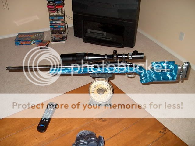

NF 12-42x56MM BR with CH-3 and she's still under 17 lbs
Here's one thru the scope... thru a blind with 1/8" opening so the neighbours can't see,,Canada eh and thus the black at the bottom of the pic, that's the bottom blind slate), thru a picture window... the white globes are about 38 yds, the green pole is 75 yds and the rain gutter is 108 yds away.
The dot is .030 moa in size and at 22x the dot to a line is 1 moa, great for quick hold-offs of 1 moa, more or less than what you set it for, if the wind picks up or lets off more.
I still have the Mk4 and will keep it for the 1 mile stuff, it is the best scope Leupold ever built, IMO.
