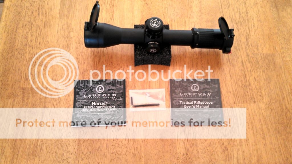

Unboxing Pics:

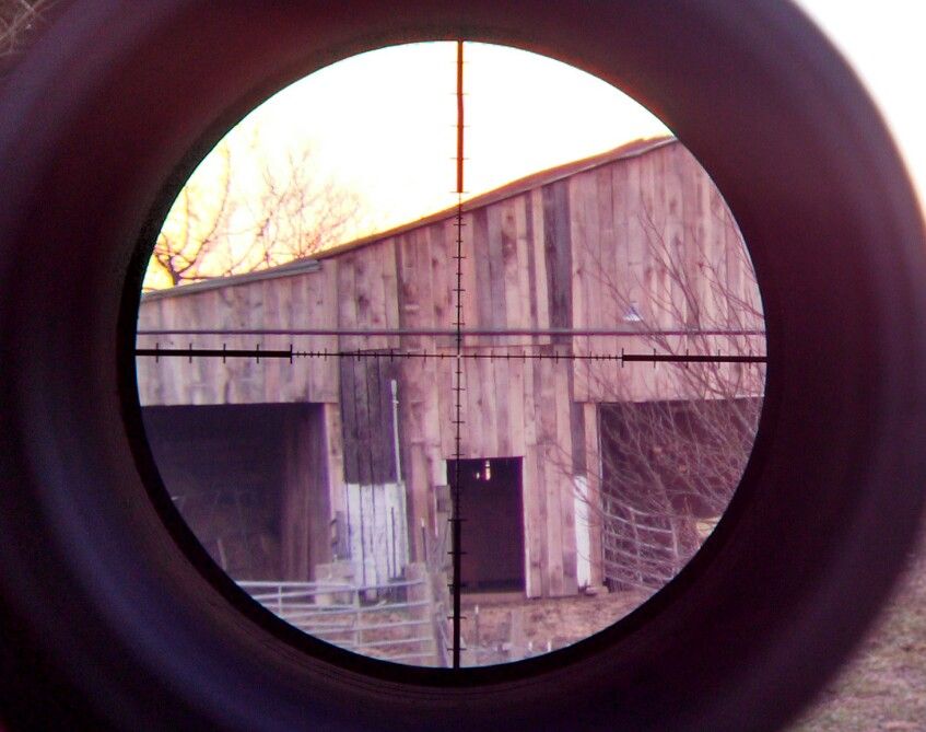

Reticle:
First off let me say i LOVE my TMR reticle. It's simple and easy to use with holdovers galore. The center of the reticle is hollow giving you the option to dial in the adjustment and make a shot without any lines obstructing your target. To the left and right of center are thin crosshairs that are 4 mils with .5 mil hash marks in between each 1 mil hash. Between the 4th and 5th mil hashes lies a .2 mil scale for target measurement. Next is a thicker crosshair line between 5 and 10 mils with no .5 mils hashes. At 10 mils the crosshair is at its thickest and extends in 2.5 mil increments until you reach a 30 mil hash and then the crosshair is solid until the end of the scopes field of view. Since the scope is first focal your power setting will determine how much holdover you can maintain if you decide to do so.
Reticle Pics:
The cell phone camera used by no way grasps the glass quality in this scope. The pictures are at each power setting.

Here's a picture of a barn at 410 yds.

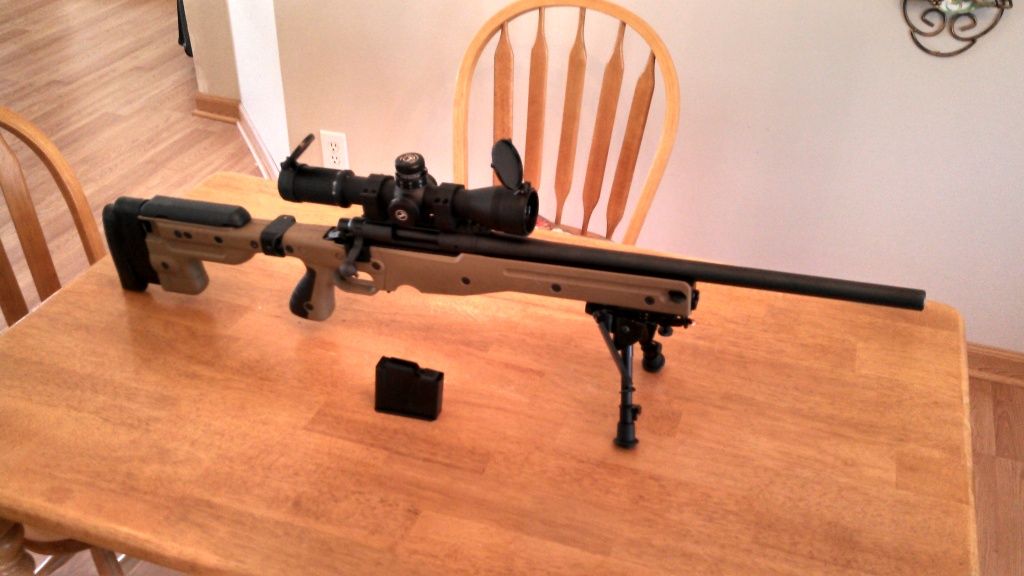

Rifle Pics Scope Mounted:
Badger 20 MOA base, Seekins .97 High Rings

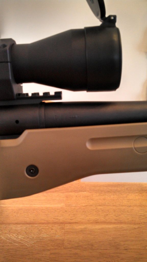

Clearance:
