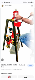

Lee press stand
I just used lag screws to attach mine to a short chunk of 2x6. Then drilled a couple of holes in my bench top and use a pair of 1/2" carriage bolts, washers and wing nuts to attach the 2x6. I have a 4" swivel vice, a lubesizer and a couple of other things that all attach the same way. Just drill the holes in the 2x6 to match the set in your bench top so it doesn't look like Swiss cheese. Use a separate 2x6 for each item.
Easy-peesy and I can remove whatever I'm not using in seconds and have a wide open bench if I want.
I used one for almost ten years and it worked out great for me. No issues with it at all. I first had a Lee Challenger press on it, then later a RCBS Rebel. It was very firm, never felt like it was going to tip over. I thought it was great!
Have the Lee Turret, Lee Classic Cast and Lee Reloader presses that I use with the stand. Stand is extremely stable and is quite convenient with the interchangeable base plates.
