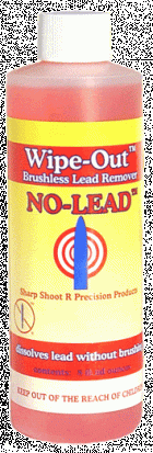

Thunderbolts leaded a Sig 22 conversion unit so bad it quit shooting. When I cleaned it lead came out in strips. I never got all the lead out till I used SharpShoot-R lead out. Worked better than any solvent for lead I’ve used.

UHMMMM the old thunderbolts... They will absolutely screw up a barrel.... I have 2bricks of them and I have been trying to decide if I want to even shoot them.... It's hard not to in this climate but I know exactly what will happen.... How hard was this stuff to use..???? I probably need to get some....

Just wet patches with a 20 minute soak, brushing not needed. I only used it on the Sig 22 barrel which was badly leaded and after a few soaks I couldn’t see any lead and the rifling was more visible than before.
If you use it follow the instructions…….
This product works. I have used it to resurrect old .22's, particularly the old model 60's
that I have such an affinity for. Follow instructions and be patient.
