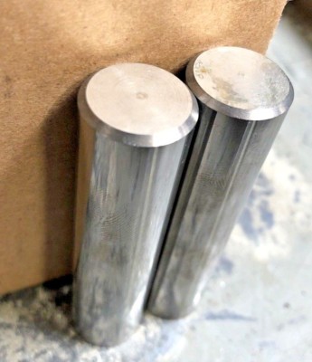

Tungsten is a better bang for the buck. Several options on eBay. Figure out how much weight you want, order a piece, drill hole and slide it in. If your stock is hollow, fill with spray foam and slide the bar into the foam before it hardens and it will make the hole in the foam for you.
Don’t plan on cutting the tungsten bar unless you know someone with a plasma cutter.
I have a long range BR rifle that I dedicated to HG. II used Tungsten round bar purchased from McMaster-Carr in the end. Initially I thought it too expensive to go that way so I found lead, melted it and poured into a piece of heavy-wall steel tubing (1" OD). It was okay but didn't add the desired amount so I bit the "tungsten bullet". After all, it only costs 200% more to go first-class these days. :rolleyes:
You can get tungsten carbide in the form of used indexable inserts and broken cutting tools like end mills from a machine shop...for free in many cases.
