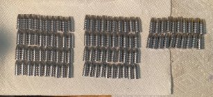

I’ve shot thousands of rounds through vintage single shot with lead bullets and black powder but it has been quite a few years back. I recently acquired a really nice, untouched Winchester 1885 in 32-40…manufactured in 1896.
Had everything already in hand to make period correct ammo- Lyman mould, WW brass, Swiss black powder. Cast and sorted bullets and pan lubed them. Determined OAL and hence space available for powder charge(full case to base of bullet). Loaded 20 rounds and made it to range this morning for my first session. No groups that will impress BR guys, but for a rifle closing in on birthday 130 it did quite well.
Rifle had been well maintained throughout its life. Lots of original case color, barrel blue in good shape and wood in great shape as well. There is some very light pitting scattered down the bore, visible only with borescope, but overall very bright and shiny.
Front sight is a pinhead, which has always given me trouble. An upgrade to match grade sights is likely in the near future. I’ll stretch in out to 100 and 200 at that point.

Wiping between shots? Blow tubing?
Most shooters, especially on this board have no idea how accurate those old single shots can be shooting cast bullets pushed by black powder.
Blow tube. Fired 20 shots total. Group pictured was last 5 shots. I’m using Swiss 3F powder and it burns very clean compared to other brands. Clean up was FAR easier than getting jacketed bullet barrels clean. Two wet patches with Hoppe’s #9, 2 dry patches, patch with Kroil and done. Cases were soaked in hot soapy water, brushed out, rinsed in hot water and set aside to dry. Accuracy may not compare to most modern rifles but it’s not much over half MOA. 130 year old rifle with sights that appear to have been with rifle since new,plain base bullets cast myself and black powder. Loads of fun if you’ve never tried it.
