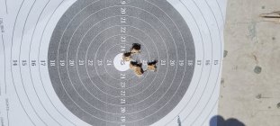

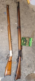

I have a Martini and Vetterli in .41 swiss.i load the Lee 44 240 RN sized .430 or RCBS 44 Keith Bullet and 8g of trailboss.
accuracy is 3 MOA and its such a cheap to shoot and assemble load I've not worried about fine tuning.
shown is typical 50 yard group.

View attachment 1358102View attachment 1358103

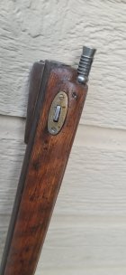

Here is the front end repair I did I had to inlet a couple of scabs as it was completely shredded and made a wedge pin and a couple of screws that I intentionally aged. I wanted it to look like an 80 year old repair. I still haven't put the final touches in the exterior finish as I wanted to get shooting it20220729_192951.jpg20220729_192943.jpg
