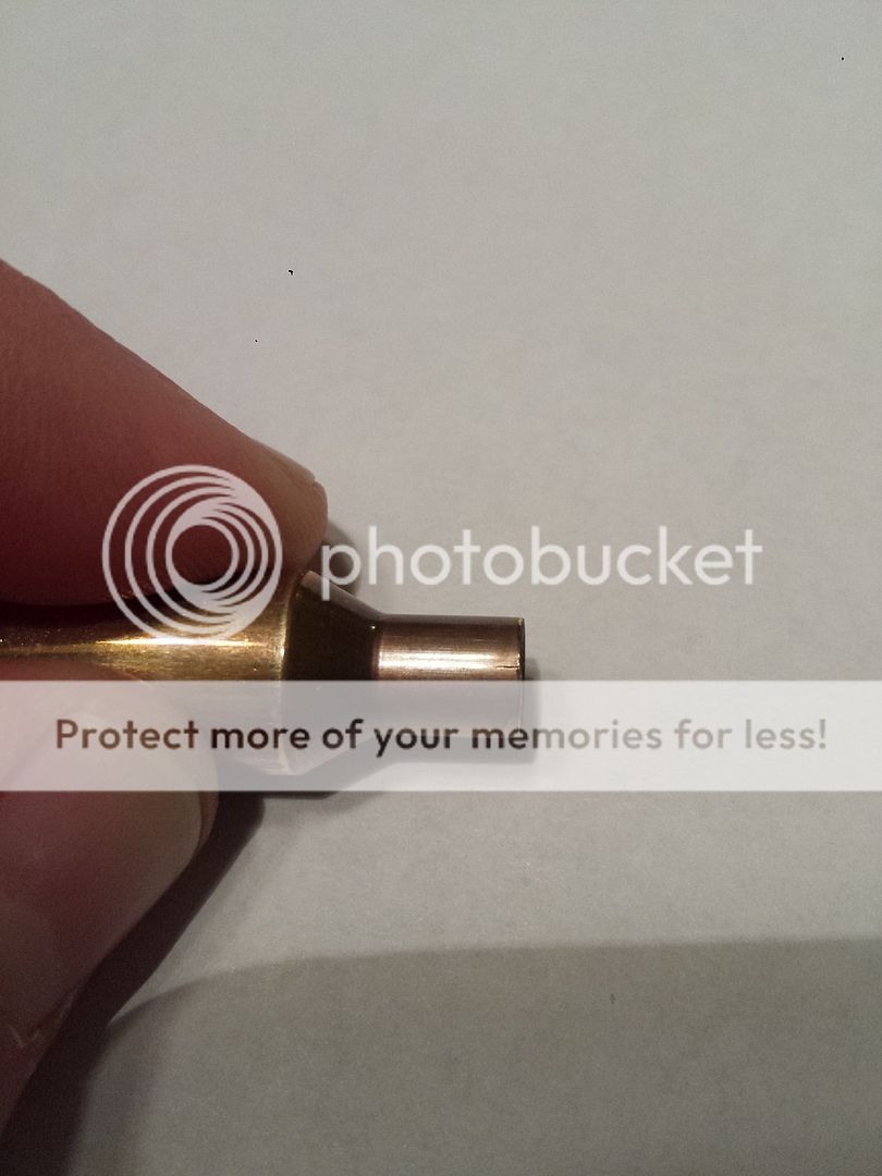

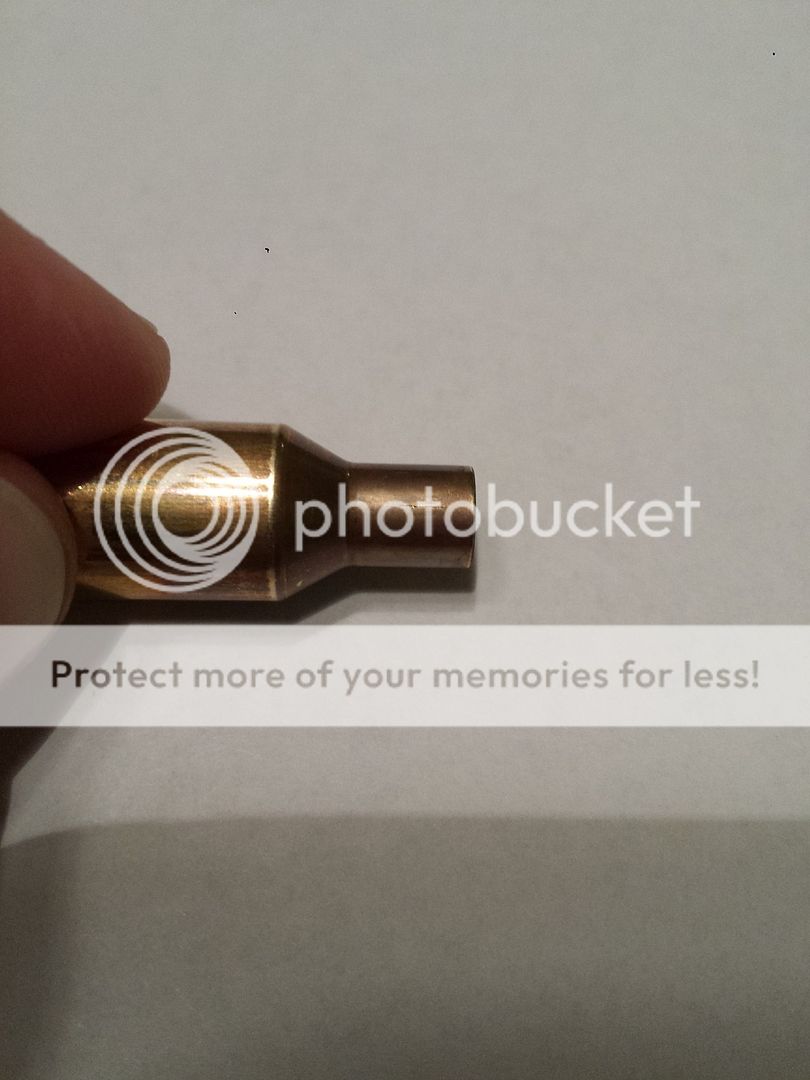

This is my my first 6BR and really like it so far. It is a 6BR Norma (so it should be a .272 neck chamber, I bought it used). I bought 200 new brass from Lapua. The first box I opened had one piece that was formed wrong (see below). Not a big deal, it happens. I used it as a dummy cartridge now.
So I fired the majority of the 200 wirh 28.6 of H4895 and jumping 105 hybrids .025" with good accuracy and no pressure signs. Then Sized them with standard Forster FL/neck sizing die. Then loaded up 25 more of the same recipe above and went shooting. I had 3 split necks! I couldn't belive it, it is only the second firing. See below pictures.
I also loaded 15 rounds of 30.0 varget jumping 105 hybrids .025" and had no preesure signs, good accuracy, and no split necks (second firing also). So did i get a bad batch of brass? Or another stuff happens and forget about it, keep on shooting?

No, I can't replace from the same lot number (unless it's by coincidence) since we don't keep much stock here in the office. I have a box or two of most of our brass on hand and replace stuff like this fairly regularly. The divots shown in the OPs photos are indeed fairly common to the 6mmBR, the 6.5x47L and the 6.5x284. It's caused by a combination of the rather hard alloy that we use, and the large discrepancy between case neck diameter, and the body diameter. That, in conjunction with the sharp shoulder angles make these cases a real bugger to form properly. These cases should be caught during inspection prior to packaging, but alas, they do occasionally slip through. If any of you should run across this sort of thing, please feel free to contact me and we'll make it right for you.
If you would, please let me know the lot number of the cases involved, as this is how we track them back through their production cycle. I do up a QC defect report that I send back to the Finns, and they will want to know the lot number. This is found on the lower right hand side of the white stripe that runs across the top of the box, and will begin with, "P00xxxxxx". If you guys see any other members here who report similar problems (or any others, for that matter), please direct them to me so we can take care of them. I spend a fair amount of time on the road so I may not be able to get back to them immediately, but I will get back to them.
