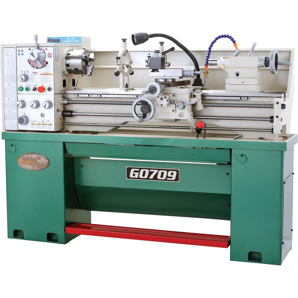

If a person wanted to purchase a lathe and learn the craft of doing your own barrel etc...what would you suggest?
I have a small amount of knowledge on using a lathe.
No intention of doing this as a business, just for my son and I.
He is into restorations and has need of lathe work from time to time.
I want to learn to do my own barrels.
Call it my upcoming retirement adventure into my 3rd or 4th childhood...least according my bride.
The NRA summer gunsmith courses are a good place to start. These are offered at the gunsmithing colleges in several states. I took four different one-week courses on lathe, mill, re-barreling and muzzle devices shortly after I retired. All were taught on manual machines. I knew something about lathe work from high school 42 years prior and watching my gunsmith friend work on my own and other firearms more recently.
I purchased my own lathe (Jet-Chinese) before I took the NRA classes. Today, I would suggest looking for a highly reconditioned South Bend or one of the new Taiwan manufactured machines. Sharp is a good brand to look at as they offer Meehanite casting lathe beds which hold up better over time.
As others have mentioned, the machine is only about 1/2 the outlay. Tooling cost is significant.
Surprised no one has mentioned Grizzly for a gunsmithing lathe. The owner is one of us
For general hobby work, in particular barrel work, the Grizzly line of machine tools are perfectly adequate.
Their Gunsmith Lathe is specifically designed for those that do barrel work in what has become a very popular way in setting up barrels to chamber. Mainly, a short headstock with a 1.5 center hole.
They are user friendly in that many run on single phase 220, a big plus for someone who has his garage set up as a shop.
Some years back, I visited a fellow shooter’s shop in the Houston area that had a small Grizzly. I think one of the big negatives is the machine simply looked cheap. And when you turned it on, the gear noise was very noticeable, leaving one to believe that the fit and finishof the internals is sub par.
But then, if you want better, it cost. And high cost tends to defeat the purpose of the Grizzly line of machine tools aimed at the hobbiest.
In the past years, I think their fit and finish has improved. This lathe here would be a good choice for a serious hobbyist.
I use a little 12x36 Grizzly. I can hold a tenth if need be, but that is more a talking point rather than practicality. I did some work to it to be a better machine. Its not a stout rigid machine, but barrel work, general gunsmith work...works perfectly. I've chambered record setting barrels and national winning barrels on it. The individual behind the machine is where its at. Attention to detail and asking yourself the "why" behind everything you do goes a long way. I train apprentices on a daily basis and I've seen it all, haha.
