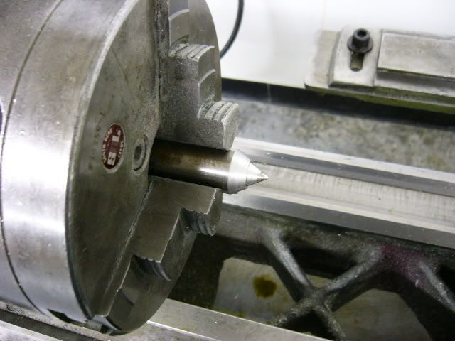

In order to align your tailstock accurately, you need to cut a test bar between centers. You can actually put a center in your three-jaw chuck, set the compound to cut it at 60 degrees, and then use the live center in the tailstock to mount a bar between the two. This shows a center mounted in a three-jaw chuck:
The center cut this way will be dead accurate as long as you don't take it out of the chuck or remove the chuck. A bar of whatever length you have on hand is then swung between centers, driven with a lathe dog. I have one about 30" long that I use. Take a cut on each end of the bar. Measure the diameters with a micrometer. If the tailstock end is smaller than the headstock end, you have to move the tailstock away from the tool. Loosen the offside set screw and tighten the screw nearest the operator. Repeat cutting and measuring until you have removed the difference in headstock and tailstock bar diameter.
