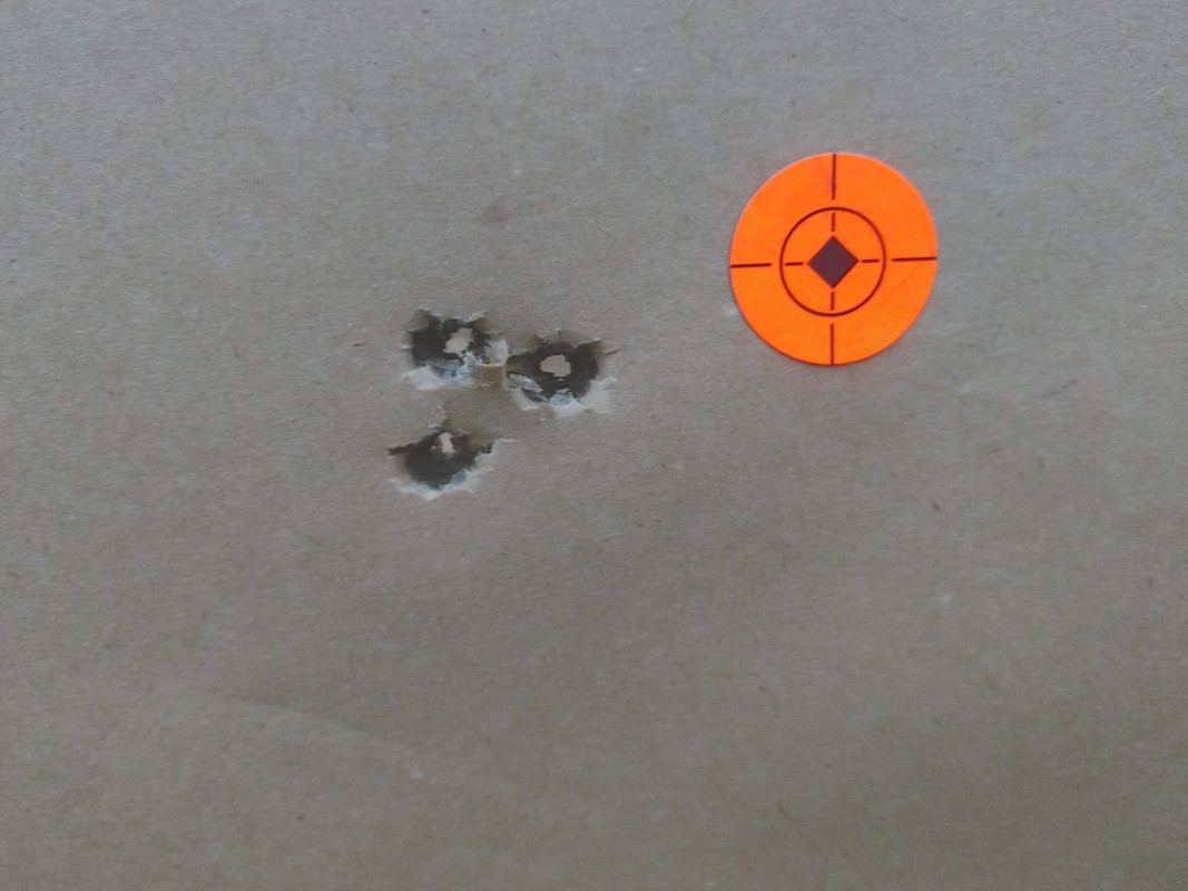

This group was shot from Lapua 308 brass
This group was shot from win or rp brass....
Same exact load. Everything was identical except for the brass. Rifle was a Kimber Montana. Range was 100yds.
The load was NOT developed for the rifle. It was my "goto" hunting load for 308s and I had a couple over the years. I was shooting up what was left while shooting the Lapua brass and did that comparison.
Take that for what it's worth. I'm sure you could change the load and get the opposite results. Maybe. Lol.

But what does that mean? I would be surprised if the brass had the exact same volume, so of course the results are going to be different.
Absolutely right. I have targets with virtually hundreds of groups which show better grouping with the same load using Lake City, Remington, Winchester and Nosler brass over that of Lapua. Those who make a comparison on a single load like that might not grasp the dynamics at play. I believe Lapua brass to be better than any of those I list - but not always better with a specific load.
I explained what it means....I know it's very likely meaningless. I explained in my post...I was shooting a new rifle and shooting up old ammo and getting a firing on new brass which is how I ended up shooting those 2 groups.
