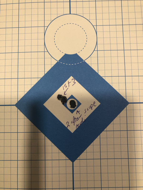

My rifle is shooting this stuff great too. Better than I would expect with wide SD and ES numbers.
I also checked and the seating depth of the bullets vary .010 in a box I checked last night. Surely that is caused from shipping and handling? I can't believe they are loading them that far out. wonder if that is causing my wide numbers?
I'm going to go through and sort them all according to length and shoot them in groups.
