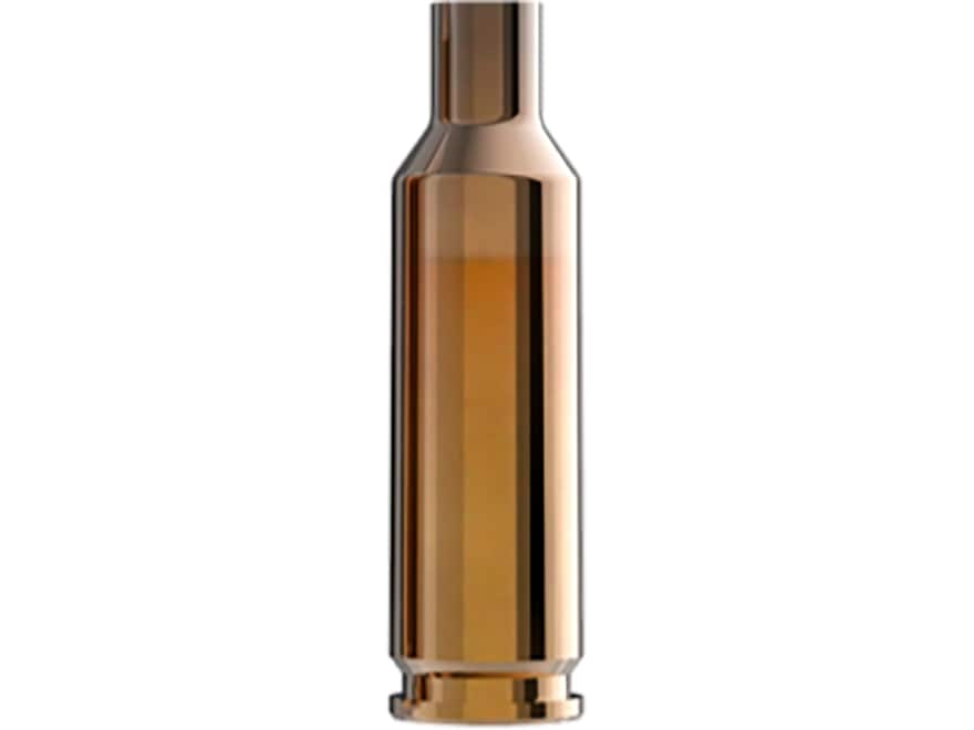

Well it does actually exist, just taken delivery. Interestingly the head stamp looks very light, almost as if it's been laser engraved.
Will you let me know what a loaded round measures?
Funny, you have your brass and nobody within the entire Nammo group could tell me this.
I will once I load some up. I need to get a rebarrel organised now.
I'm in sunny England, I just happened to see some in stock and got it ordered. I had some on backorder from the importer but hadn't even heard back back from them. Just gathering all the components before getting a new barrel.
