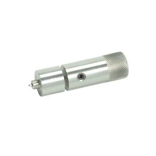

They are punched. If they would drill them the production speed would decrease greatly. Sinclair flash hole tool reamer was .0625. You have to realize also that decapping pins are cut from wire stock and their diameter can vary. The .0625 was picked so the the decapping pin diameter on the big end of the specification would have sufficient clearance and not " stick" in the flash hole.
