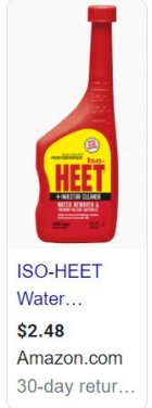

1 oz of Lanolin to 1 bottle of HEAT works very well!
