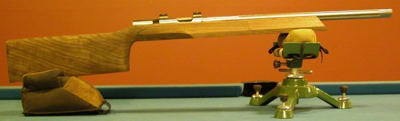

I used titebond III on this one. I found a tiger stripe piece of maple that was returned to the luber yard and I figured that needed to become a stock. This was 3 pieces of 3/4"x8" maple. Stock has been finished for about a year and it's still holding strong.
