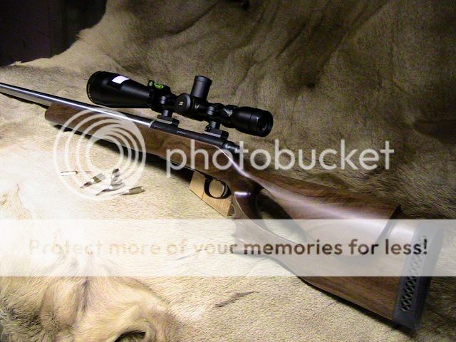

Looks pretty good to me. What NOT to use is pretty much any white glue, they are mostly water soluble.
hey Bruce,
What type of clamping system do you use? that pistol looks like it would shoot off the bench real well. how much does it weigh?

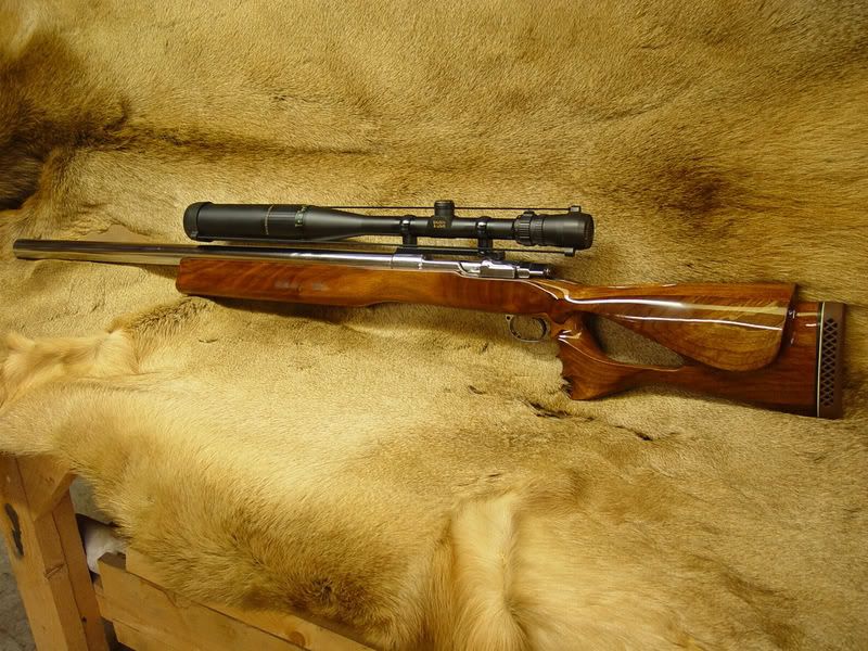

I used 8 clamps to hold it until the original glue cured out..
Thats a 338/284 Winchester, with a 1.250 20" barrel, it tips the scales at 16#'s

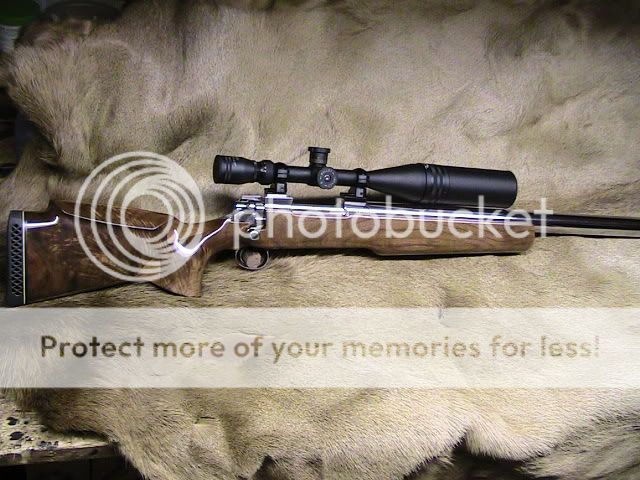

The Tortoise and the Hare. The Tortoise is the 6 BR, the Hare is a 6-06. 58 Gr. V-max at 3975, or 68 gr. Berger at 3825.

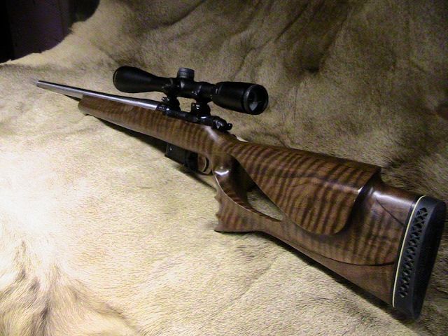

Above is CZ 527 in 223. The truck gun.

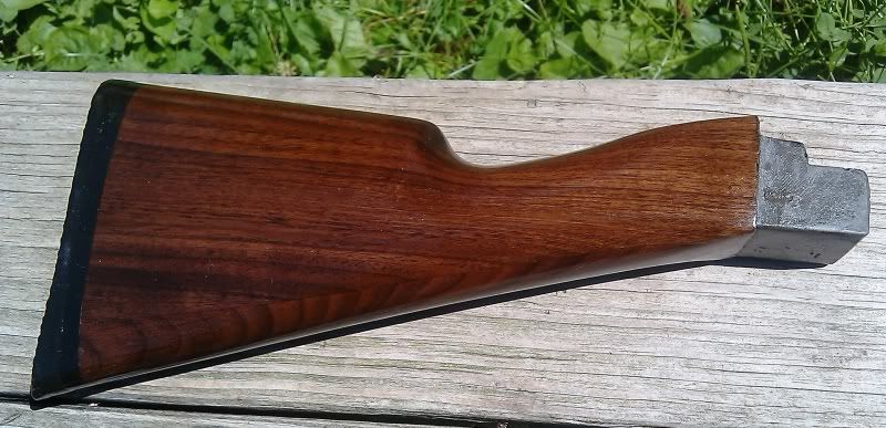

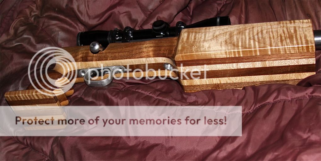

All of the above stocks are laminated, although it is hard to see on some.
As far as glue is concerned the yellow interior/exterior glue like Titebond and Probond work very well and are reasonably priced in gallons. I tested a lot of glues and was surprised that I could soak little pieces of laminate in water for almost a week before the glue joint would let go. Gorilla is fine, I did one stock with it, but I prefer Titebond.
