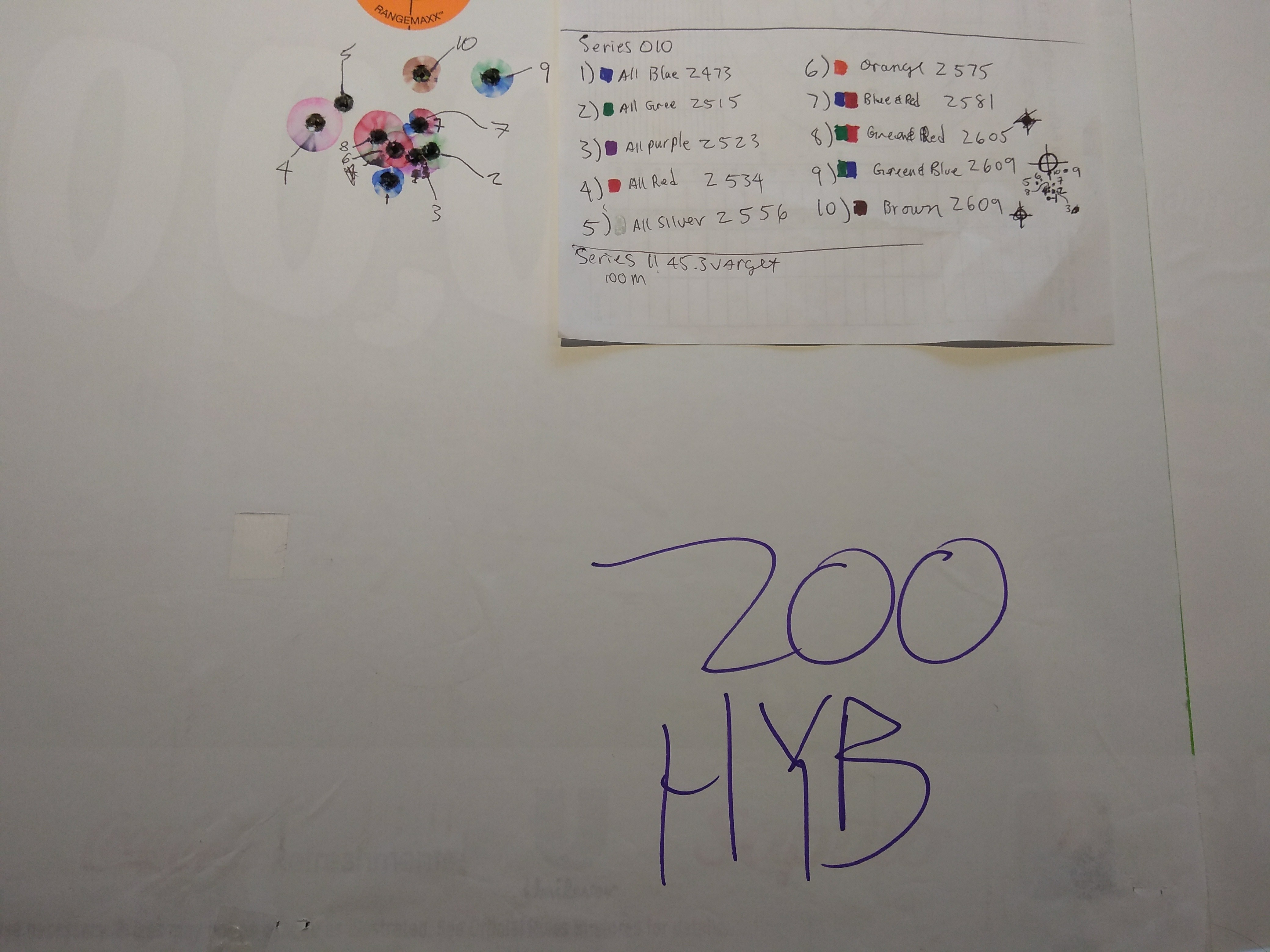

Just did the test today using the Sierra methodology at 300yds using the 195TMK and 200 Hybrids. The 200hybrids was ~2” of vertical at 300yds unfortunately I can't push it out further to test. But I think i got a good enough data to proceed with the next steps.
