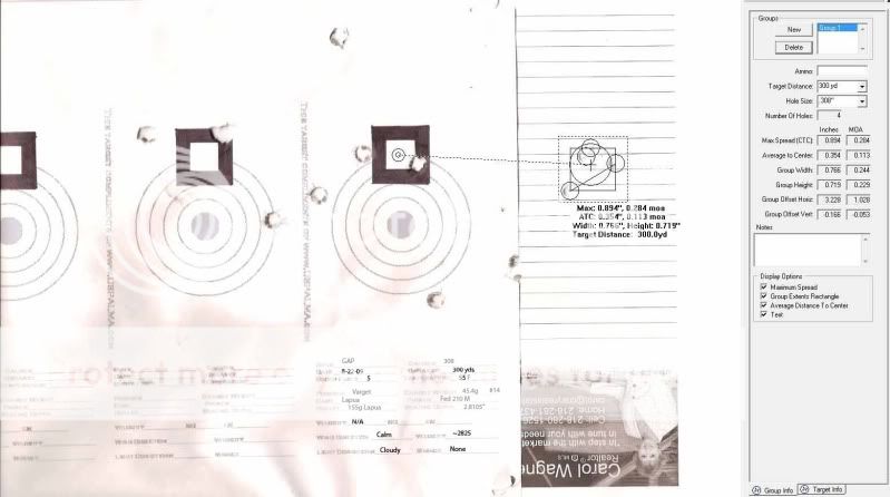

Well guys I think i'll stick with this load. It took me a few rounds to settle down. but I ended up with a decent group with one flier that I can attest to.
All of my groups were shifted to the right about 3 inches for some reason.
The second target over was the 3 sighters, and the third target was the first 5 round group and the group that was off the paper was my last 5 round group of #14 powder load of 45.4g Varget. I had to add paper and punch in the holes.
I just thought you guys would like to know the progress. I wasn't able to chronograph my shots for some reason my chrono wouldn't read, it kept coming up with an error.
Thanks again.
Deano
the flier was low and left. all the other shots I didn't bother numbering. or going down to number them. it was only me the day i shot so i didn't have anyone in the pit pulling for me. I'll mess around with it a bit more here in the coming week.
It was .854' at 300yds, or about a 3/10 MOA, that isn't to bad for me.
