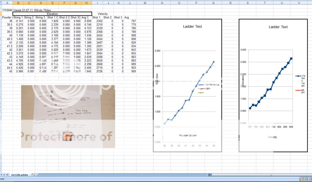

Ron,
I do like your graph! What software are you using to make the graph? Looks like it would really be something great to keep in my records. Usally I hand write and explain all my findings in note pads. Is this program user friendly? I really have got to catch up on my PC skills!
Mark
deadlyswift said:
Ron,
Mark
It is Microsoft's spreadsheet program Excel. More recently I have been using Open Office Calc, which is nearly identical to Excel, but is available to download for free from Oracle. Spreadsheets work well for storing data, and manipulating it -- calculating standard deviation, extreme spread, averages, etc, and obviously graphing. They can be a little daunting to use, but the basics are fairly simple. I've attached a copy of spreadsheet I used to make the graph above. I suspect you will need either Excel or Open Office Calc to open it though.
RonAKA was nice enough to send me his Excel file, from another post, so I could work this up to keep my ladder test documented. Thanks again Ron.

Guess I'm getting too old, 62, but I loose targets, and in a year or more I might like to review it, sell the gun with info, or have someone ask me about a load, and need something to reference it to. You can see I put the pic of the target with the data because I agreee with you the target is all you need...but everybit helps.
