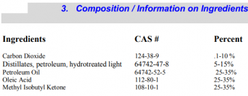

Sounds like it’s safe then.
Of the constituents listed, the oleic acid is the least concerning in terms of health and safety risks.
You actually get it in your diet with many veggies and it is the part of things like olive oil that is credited with health benefits.
Stuff like MIBK (methyl isobutyl ketone) is a solvent known to be good for nitrocellulose among other things. I would be careful with any and all gun solvents that are hydrocarbon based. Be careful with any and all ketones, xylenes, acetones, etc., and treat them with respect. Your lungs, liver, kidneys, etc., do not come with a warranty so take good care of them. YMMV
