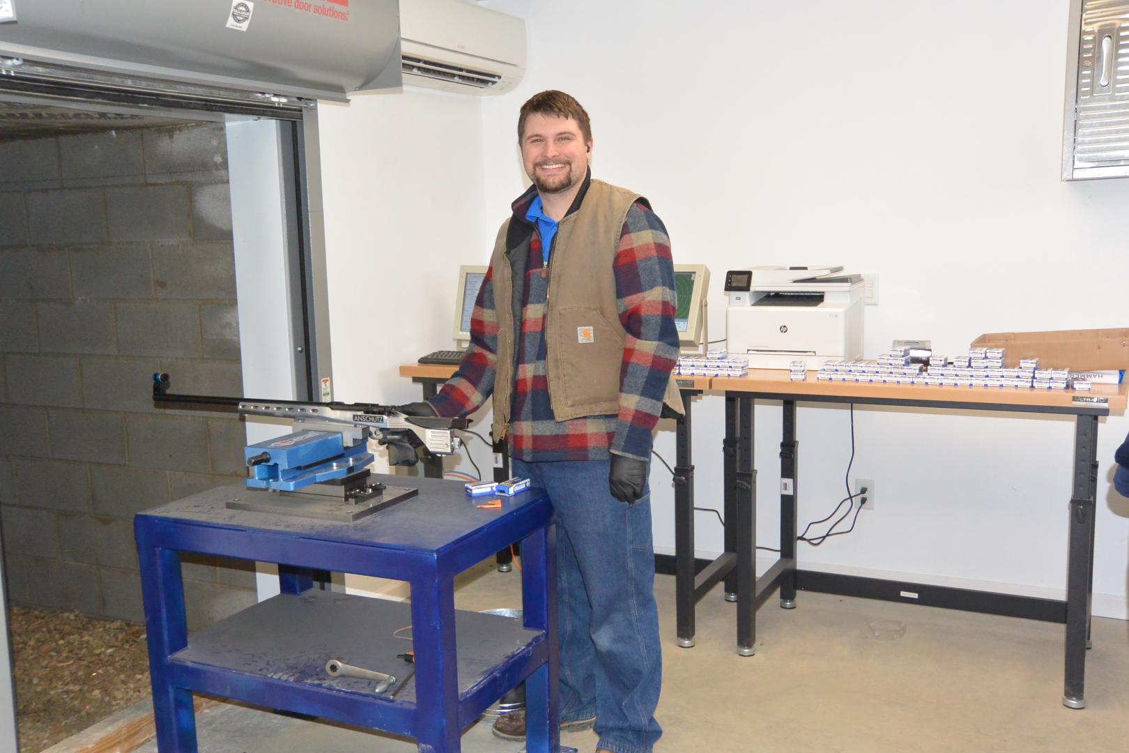

A very good read here. Many top tier guns tested with top tier ammo in a controlled environment and the human free influence of a machine rest. These are typical of the guns this thread speaks of and are not necessarily dedicated IBA bench guns.
You might want to cut to the chase and convert all the mean groups or the best mean group from the most accurate gun from metric to decimal. Anything less than using the mean lacks empirical value.
Here I did it for you. 10 top flight guns. Best 100 yard 10 shot average gun was the 2500 and the OD was 28.329 which converts to 1.115". Subtract .22 and you get .895" ctc. Very impressive IMO.
Worst is 33.89 which converts to 1.334" subtract .22 and its 1.114" which IMO is also quite impressive.
