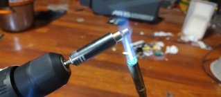

Describe, in some detail, your flame annealing.
In sort I do the flame change anneling method the guys from primal rights talk about. Do. Cheap cordless drill ,socket, propane torch. Try and hit it at the neck should junction and just spin it till I see the flame change. From my little experiments with it . Flame seems to cagne right around. The same time I get a bit of red glow on my brass right around the came mouth and into the neck a bit and when my 750° tempaqi does its thing
View attachment 1647740View attachment 1647741
You'll get more consistent results getting your necks hotter. I know. . . a lot of people worry about ruining the case, but it's really not that hard or that critical to the annealing done where you get more consistent shoulder bumps. You need a temperature of ~ 1,100 - 1,200°F for a second or two to get a more proper annealing. To get proper annealing with 750°F takes way too long (like, measured in minutes). When in a darkened room you see the neck turn red, that's a good indicator that your at ~1,200°F and you only need that for a second or two.
When I was annealing as you are doing, I too was getting similar variations in sizing as you. . . even when I incorporated a 5 second dwell time (leaving the case fully in the sizing die for a time to reduce springback). Since proper annealing process is a function of amount of heat over a period of time, a shorter amount of time with higher heat was needed. I've observed this in an AMP demonstration where I saw the case necks glow really red, but just for a moment. That got me to thinking, I really need to use more heat, though not for a much long time.
When I was using the "flame change method" it took 4-5 seconds to get that color change and I'd drop the case out of the flame. Now that I've gone to the "glow method", it takes ~ 9-10 seconds for a good glow and drop the case out of the flame at that point (.308 cases and 6.5 PRC cases). I make sure the flame is focused on the neck close to the shoulder and not much at the shoulder-body junction so that it's only the neck that glows. I find I get real consistent sizing and no issues for the case body.
Since I bought a hardness tester, I found it interesting how, in order to get the my target hardness the same as virgin Lapua brass, I had to get the necks just a little softer from the annealing as the sizing process brought the hardness up to my target hardness. I was a little surprised by how much the sizing process work hardens the brass.
So. . . you might experiment for yourself to see if you can improve your consistency??? Just don't point your flame at the shoulder, like in that second picture of yours. ;)
