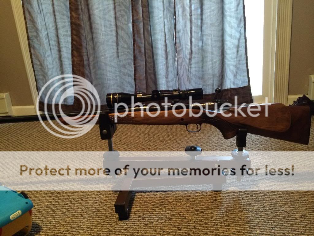

Hello all! New around here and can't believe I have gone this long without discovering such an awesome forum! I am a rimfire nut but also love centerfire as well. I just got my hands on a barely shot winchester model 70 which was made in 1967-68 in 22-250 with a factory heavy barrel. I have done some accurizing work and she has improved but not to my liking. Since I scored this rifle for free I feel dumping money into it is totally acceptable. It will be getting a new thumbhole stock that will be pillar and glass bedded. It will be sent to krieger to get a new stainless barrel in 22-250 1-12 twist with the factory heavy barrel contour. Will also have the action/bolt face squared and trued along with a tubb 2000 firing pin/spring combo. I've already modded the trigger and it is perfect! My question is what's a good press and die combo to reload for max accuracy? I'm not looking for speed and don't mind being able to load one at a time or measuring my charges one at a time. As long as I'm getting max accuracy I'm happy. I'll also branch out and do the same for my 30-30 and 300 win mag. Any help is greatly appreciated and if you need anymore info from me just ask!

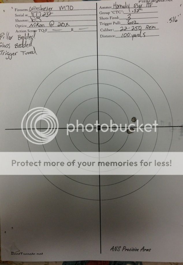

Edited to add a pic of the 22-250 and a target after I accurized it. Before it was doing 1.25" or larger groups with the same ammo!

Boy oh boy, that thing is beautiful 'as-is'. I'm sure you could get it to shoot without doing a complete make-over, but hey... if you got it for free, go for it I guess.

Good luck and enjoy. But I would focus on the reloading and just see what that thing can do before getting into anything that major on it. If you have the trigger worked out, you should be more than half of the way there already.

She does shoot pretty darn good now and with some handloads I'm sure she could do better. I'll def see what I can squeeze out of the factory barrel first.
