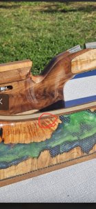

Brian Blake Eminence action inlet and bedded by Alex Sitman chambered in 223. Hopefully it makes it home in time for Nick to get it tuned for BSWN.
Dennis Ray took this stock over the top when he made it, this thing is WILD!
Next is a Cerus walnut and quilted maple Fopen, rife is built by the infamous Zack Donovant of Old Dominion Custom Rifles for Gene Parish, 6.5-7 FCP that will be glued and screwed.
Both of these projects were a pleasure to work on for some really great guys.View attachment 1626077View attachment 1626078View attachment 1626079View attachment 1626080View attachment 1626081View attachment 1626082
I absolutely LOVE THIS stock. The live edge is beautiful. The only change I would have made (and it is a very minor modification that I could certainly live without), would have been to put a slightly larger radius on “cheek rest” area. See below.
View attachment 1626199For some reason it won’t let me attach the screen shot that I marked up.
Dave.
Thank you for the feed back I really appreciate it. I’ll play with the design some and see how it looks.

Its got a soft radius, your just picking up the CF line in the pictures, me not a photographer and I'm always pressed for time so I don't look at things the way everyone else does.
What i might suggest is getting ahold of D Ray and get you a stock, let's quit bullshitin and make something cool.
Not trying to sound snarky, just trying to get you behind something special, you know I got nuthin but love for ya !
Dave.
sure its nicer to get your hand around but ive had cracks in that area. the deeper you make that cut the weaker the stock is there and thats a weak point anyway. im trying to figure ways to strengthen that area. ive got one where the stock almost cracked in half at that spot. i drilled a 1” hole through the wrist and filled it with devcon and stuck a piece of 3/8 steel allthread in it. holding so far but i wanna try to prevent that.!
