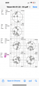

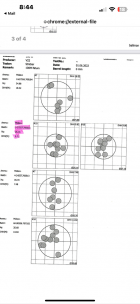

Just Back from Capstone for Lapua lots
I brought my newer Tikka T1X and my Bergara B14R. Dreaming they would both like the same lot
but Oh-No honey. As you can only buy one case of the lot you chose I bought the CTR X lot that
shot best in the Tikka as it slightly outshined the Bergara.
I highly recommend the trip for anyone shooting .22LR competitively.

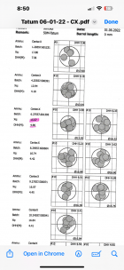

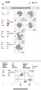

These are my V22 results for comparison:

So a .480” group center/center for how many ever shots, was it 10 or 20, I don’t remember. Those results give me a migraine trying to read it.
Unless the test center has changed how they measure, the op post is 20 shots .60 in diameter, not center to center. Center to center would be closer to .38. Big difference between 5 shots and 20.
Edge to edge is the way they measure. I was hoping for better quite honestly.
Mesa wait is 7-8 months now. The numbers are for two ten shot groups.
