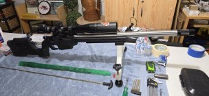

Just installed my KI Precision pre-fit barrel last night. It’s a monster! 1.250x24”. Ran a quick 10 rounds through without issues. Will work on sighting it in and ammo test today. Hope to make it to a 100 yand Egg shoot tomorrow.
Have only put maybe 80 rounds through it. So far it seems to be really good. 100 yards <1 moa. Only trying 2 different Lapua ammo's. Going kind of blind tomorrow for the egg shoot. I'll let you know how it goes.
