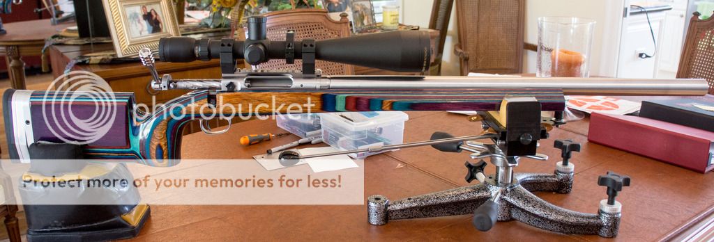

If you are curious just go with a shadetree top. Mounted one on a Caldwell base for a while and now have it on a bald eagle. Has worked great for me after little tension adjustments. Definitely improved my consistency. I usually do have to move the stick after each shot, but it is so easy and fast I don't believe it to be a distraction.
Also, I cut the knob off of the back screw on the bald eagle almost flush with the lock nut so I can get it as low as possible and still have good range of motion for f class.
I like your setup. I was thinking of heating up the stick and then bending it. But. I see how you just cut the adjustment knob off. Gonna do that to mine today.
I made a longer one out of stainless and bent it. I couldn't get used to it.
I have this exact setup. the joystick knob on the Shadetree is threaded on. i made an extension so the joystick is easier to reach prone and so the rear screw head does not interfere with the knob when lowering the joystick. my rear screw was also cut down to lower the profile further as he has done. works great. btw, my Shadetree top allows the rifle to return to the target with very little re-adjustment, no problem
