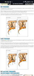

Jewell trigger how many rounds is it good for?
The BR trigger lacks that small piece that always seems to break. So I would assume that it should last a lifetime if used and cleaned properly.
