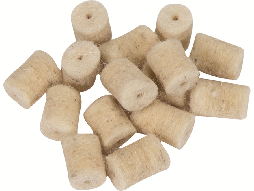

I use the felt pellets, impregnated with JB or Iosso, with the appropriate pellet holder, and love the results! They work well and are dummy -proof! Lol

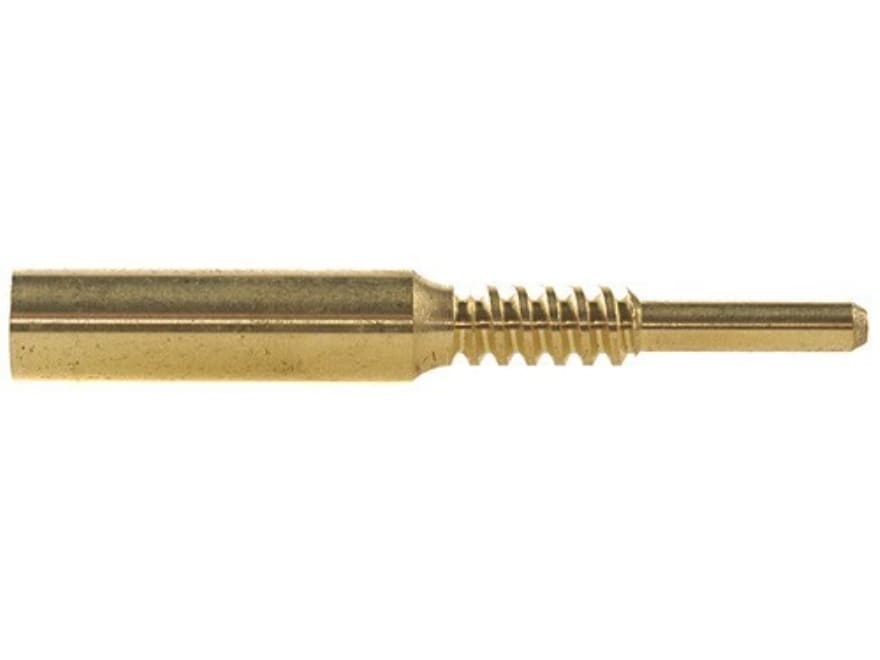

Shown is how I use a Parker-Hale jag when using abrasive paste. Roll on a full snug fitting patch and wet the patch end and close the wrap. Smear a liberal amount of paste on the full outer surface. Moisten the patch with a few drops your favorite solvent.
The other pictured jag is home made from bronze rod. It is slotted to accept a pre made roll which is smeared with paste. I spin it in a drill to remove stubborn carbon deposits in the chamber necks.

What Divigin said Parker Hale jag. When you wrap the patch it may be too tight just unroll a little and trim it off with scissors till it is tight but not too tight. Remember how much you cut off for the next one.
I, too, use Parker-Hale jags with paste cleaners. It has never made any sense to me to wrap a patch around a brush, there's simply too little support, too many gaps between bristles. And bristles can poke through a patch, seems to me. The Parker-Hale also has some gaps between its "lands", but the tops of the lands are semi-cylindrical and very broad compared to bristles. A tight patch will be much more effective at scouring and "short-stroking" abrasive compounds like J-B.
I find (or cut) the best size patch for a loose, snug, or even tight fit in the bore, and wrap it around the jag forming a cylinder (sharp "teeth" grab it and help hold it in place.) I feel this applies cleaner more evenly to the bore. But you can also use it to simply push patches through like a pointed jag, as when trying to remove crud after soaking.
