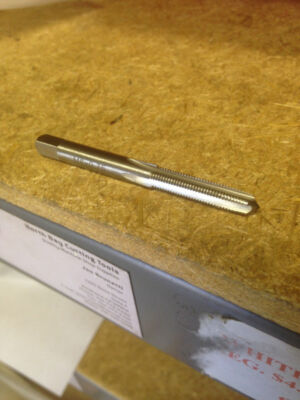

Pulled apart one of my junkers, that I drug home to be fixed at a later date. It has a broken off front action screw. I can find screws, but i am concerned that the threads are damaged in the receiver. I have looked online but failed to find out what the thread size is. does anyone here have this info or can point me to where i can find the size to buy a tap? Any and all help would be appreciated.
It has oddball thread pitches that are no longer used.

We looked at thread gages and the only 2 that were even close was a 6. x1. but it would not start in the hole. The screws from another rifle that is also a type 99 would go in a 1/4 X28 but were a little too wobbly to suit me. Any idea where to find a 6 x .75 tap
Yes . Thank you and Short Grass both!!!! I found a standard tap and a bottoming tap as a pair on Amazon that will be here on Monday. Ive been watching Mark Novak and I don't think I ma going to go crazy on this one like he does. It has 0% finish on the metal, the stock looks like it was drug home behind a Sherman tank all the way from Japan. I steamed a lot of dents out but it still has more , i will try again. The stock is a very white colored soft wood but it has a mahogany hand guard. The stock was split from the tip to about 8 inches in front on the front action screw, and I have glued it back the handguard is split in two places and yet to be fixed. After I scraped the stock finish off I noticed a bunch of black marks that look like someone was trying make the stock spotted, Lacquer thinner would not remove the black marks so i am going to try a few with some wood bleach I have in the shop to see if they will clean up. Would you try to go back with the varnish looking finish the stock had from new or just use BLO with some stain to darken it up???
