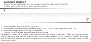

By the way, the Tikka recommends 62 inch lbs for the metal trigger guard and 44 inch lbs plastic trigger guard - you can download a manual directly from the Sako/Tikka website.

The torque setting is different for plastic than it is for metal. 60 inch pounds will crack that plastic.
