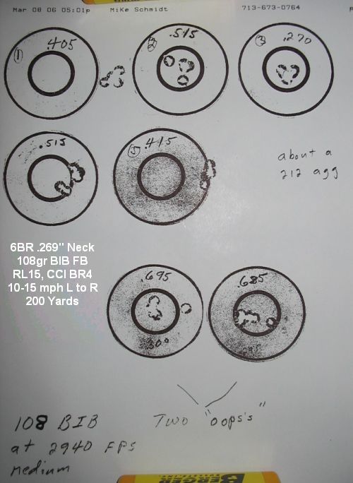

Jackie tested the BIB 95s this weekend with N540, N150, Varget and RL15. Again the RL15 yielded the best results. But Jackie and I were both a little disappointed. The 95s produced nice round groups, but they were running about .3 MOA .
For the heck of it, Jackie had some of Randy's new 108gr FB bullets. Even though our throat was maybe a bit short for them, Jackie was able to seat them .030" above the neck shoulder junction going .010-.015" into the lands,estimated).
The RL15 combo with the BIB 108s shot really well at about 2940 fps. Here is Jackie's target. He shot 7 groups because he had two "Four and Ones" were he felt he just missed the wind call. The four-shot measurements on those two groups were .300" and .295" respectively. That's .150 MOA folks.
Mind you, these results are with thrown,not weighed) charges and the wind was blowing 10-15 mph, full cross-wind:

I started with Varget at just under 2900 fps. the results were similar to the 95's. then, I said why not try the Reloader-15 that had worked so well with the Berger 105 VLD. I base lined the the 107 with with the Reloader-15 at an average 2940. After several 3 shot groups that looked good, I decided to shoot an agg.
First, let me say that I was forced to shoot the most hated condition of all for me, a straight ac cross that was left to right. You can see by the position of the groups on the targets that Paul posted as to how much "push" I was fighting. That was the only consistent condition that the range would give. The groups,,this is 200 yards, actual measurements), that I included in the agg measured .405,.515,.515,.270,.and a .415. That come out to a nice agg of .212 moa!!! Pretty good for a straight across condition.
But I will admit that I fudged a bit. I actually shot 7 groups. The other two groups went .685 and .695. Both were a classic "four in, one out", with one shot killing each group, exactly straight to the right, with the condition. The other 4 shots in both groups were very good, in the "low three" to "high two" range. If I would have put those two shots in those two groups, the seven shot agg would have been "sub.200". Even with the two groups added in, the 7 group agg was still a .250, not bad for 7 groups with no "gimmes". But I was still VERY aggravated at myself for missing those two shots. You will just have to take my word that this is not as easy as many might think, even taking your time and concentrating to the best of ones ability.
From this, you can see that the 107's worked really well, much like the Berger VLD. However, when I shot that great agg with the Bergers, I had what I call my "dream condition", a 10 to 15 degree over my left shoulder. I will be the first to admit that I would rather suck rotten eggs than shoot a straight across condition at 200 yards, especially at Tomball, which is not known for giving away good aggs in the first place.
I did not mention what the exact load was with the 107 BIB and the Reloader-15. Suffice to say that the medium velocity was right at 2940. I could have easily pushed it past 3000, but the good agging capability seemed to be where I was at. This is a pretty darned good bullet in this barrel........jackie
