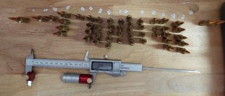

Here's an example of 49 custom 6mm. All measure the correct bto.
These rows are oal.
They are spread out more than the other customs normally are but still within a small measurement. 2.431 - 2.450
The Berger's i had last year required double the headers. 2.413 - 2.470 or something like that. There would be several rows of singles.
I want the 2.431 not to be next to the 2.450 at a match.
I put them in the box in order highest to lowest. First Sighters come from the ends. In this case 2 from the beginning and 3 from the end. Then i just shoot in order because they are all so close.
Just the way i play with my toys !
