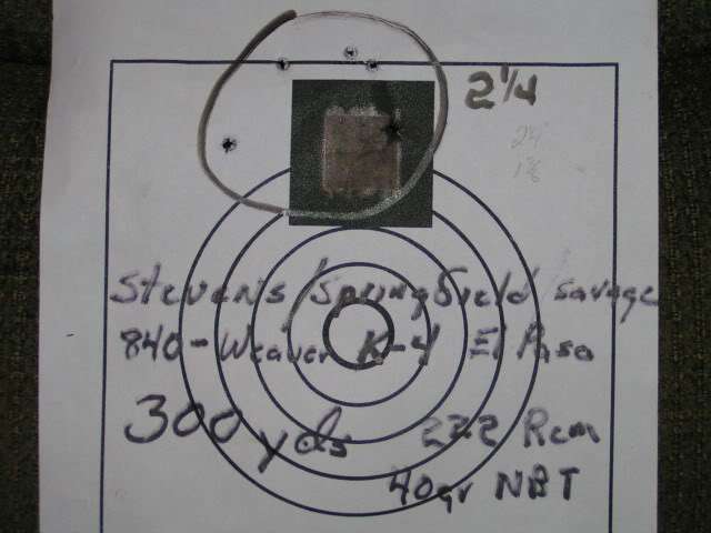

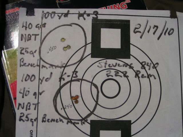

I had an ugly Savage 340 in .222 sporting a 3-9 steel tube Weaver, very accurate with handloads and light bullets (1:14 twist).
I was at the range shooting it when the local Police Snipe Team came to shoot their 3 Rem 700's in .223 with 3-9 Leupolds. I was looking at their targets, through a spotting scope, while they were shooting and the ugly 340 was better for accuracy. Their best group 3 rd was about 1.5" and mine was a 10 rd group of 0.7"
Stupidly I sold the gun and wish I had it back.
I now have a Rem 700 in .223 with a 1:9 R5 barrel.
Some of those 340/840 rifles were scary accurate.
Shot the bottom group and thought it was a fluke so shot the one above. Needless to say it lived on 40gr NBT's
I put a little more scope on it and moved back to 300 yards.
