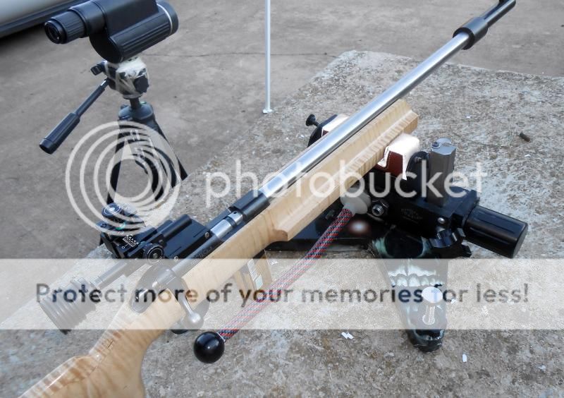

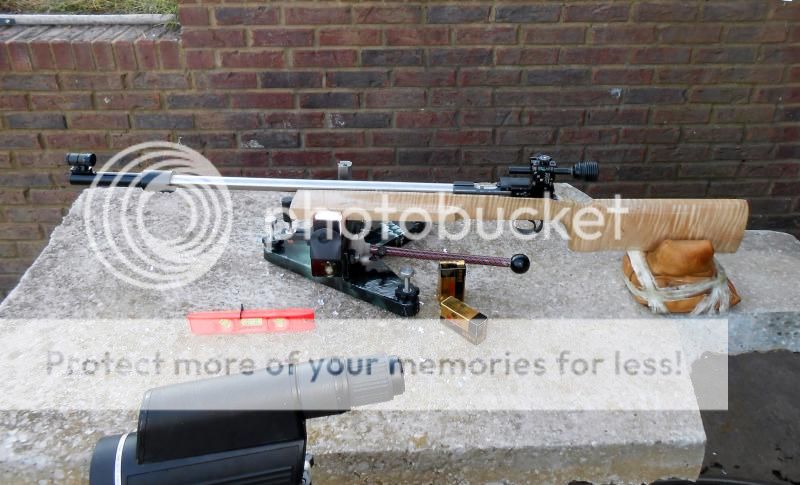

I put together a CZ 455 with a Dan Lilja .900 no taper EPS chamber bbl and bedded in a Don Stith Classic BR stock that shoots lights out,,I have 9-10 CZ 452 22 rifles and the Lilja bbl 455 shoots well inside all of those,,I also have a 1957 Brno Model 4 that shoots better from position but from a rest the 455 Lilja Stith is my best shooter,,having put it together myself I think I have right at a grand in it,,with the new CZ Fly trigger it may shoot even better as the best I could get with the factory trigger and a Dip sear is 7 ounces,
I do most of my 22 bench shooting with sights and for score,,
rifle set up with PNW sight and 4 inch bloop and Gehmann Iris front and rear,,
