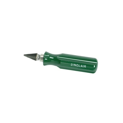

I purchased the Sinclair chamfer and it’s absolutely amazing how smooth it cuts! I chuck it up in drill press @ 250 rpm and it’s amazing how fast you can deburr and lot of cases

Good sharp hand tool:
...and the correct angle to match most boattails...unlike most of those from the reloading industry, many of which I own.
