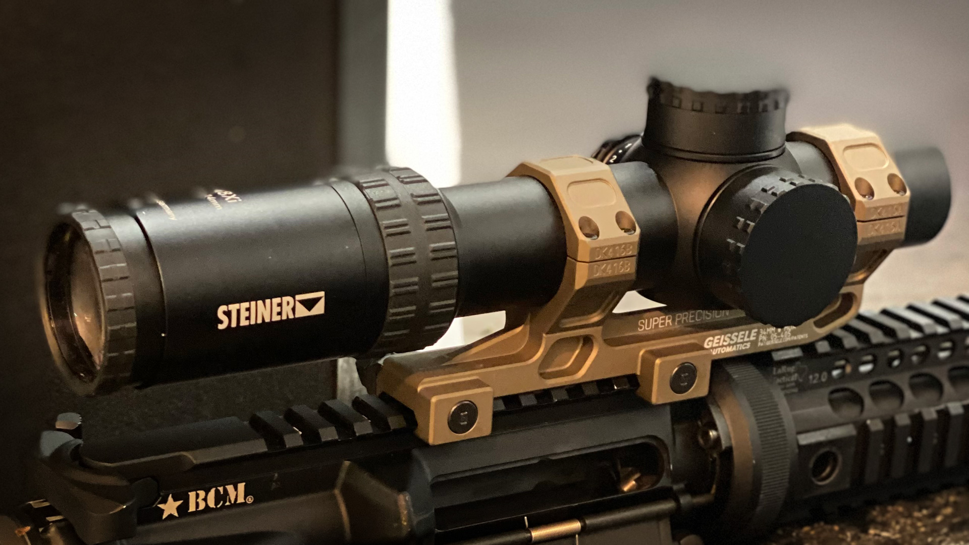

Here you go ladies, Dual focal plane its $4K but best of both worlds.
Bold for those reading challenged.
"One thing that sets this Steiner apart from other scopes in its class is the fact that the scope has a dual plane scheme. At lower magnifications, the reticle appears on the second focal plane which makes it quicker to acquire targets compared to its first focal plane only counterparts, but when adjusted to higher zoom levels it behaves like any other FFP optic."
