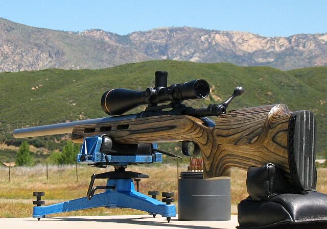

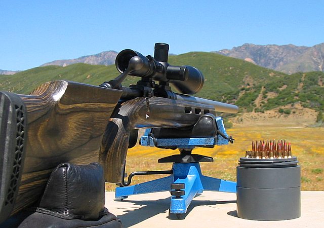

Think of a 2.5 left going to a 2.5 right,or back and forth). At my range we have two mountain valleys that come together in a "T" at the target line. In the 600-yard matches the wind often switches back and forth at the top of the 'T' even if it seems steady at the firing line. I've seen many "good shooters" miss a Left to Right shift at the 600-yard mark. We don't allow personal flags past 50 meters, and there's just one flag at either end of the 600-yard line, placed about 30 yards away from the targets, so it is actually VERY easy to miss a switch. It can also blow left at one end of the target line and right at the other. Anyway, you get the idea.
At Sacramento I've seen a world record holder launch ALL 10 shots in a 1K relay off paper. And we all know the horror stories from Raton.
My range, looking down at 600. There's one flag on left end of distant berm, one at right:
Hills on right side of "T"
