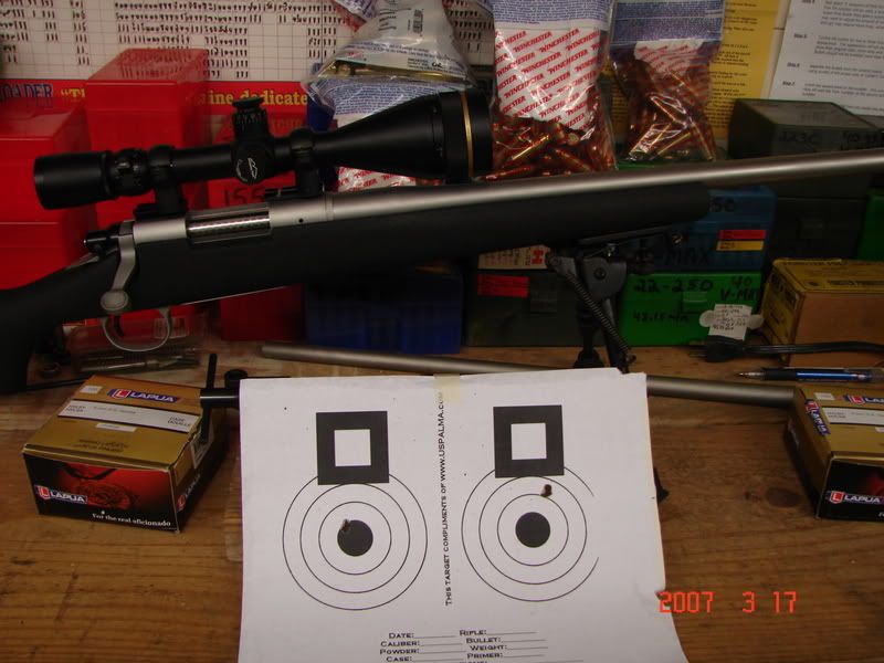

Just picked a load from the "Varmint Loads" page on this site and loaded up a few to sight-in and get a feel for the gun. Was astounded to find it,68gr Bart's/29.6 grs H-322) shot several 3 shot groups on the low to mid .1's... Can't wait to try it out on Crows and Groundhogs...
Those are some mighty fine groups and that is one mighty fine looking rig as well.
Mine is coming, soon, I hope. Can't wait to get her.
Woody
