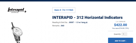

So Its official Im tired of fighting with the tools I currently have and Im wanting a interapid indicator dedicated for barrel indicating only. What is the model that is best for the task.
My goodness the price on these now days! it’s been a long while since I purchased mine but they have doubled…. A quick glance says the one on eBay might be the best option for new. Good luck!
There are a lot of counterfeit Interapids on Ebay, If the price looks to good to be true, It probably is. I would buy it from MSC or somewhere like it.

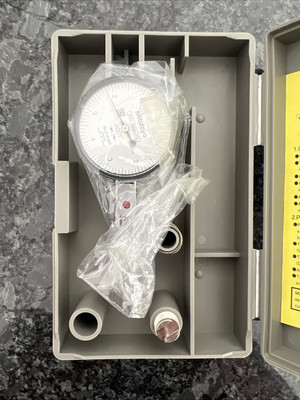

I really like my Federal Testmasters Yellow Face .0001" for the price
But Do recommend a long stylus with whatever brand you choose.

I like the Mitytoyo 513 series because I can reach into a rough drilled hole and indicate the throat in my Benchrest Chambers without such a long stylus.

I am NOT paying $600 for an indicator, lol, as nice as they may be.
Interapid: where do you find the "V" ? I'm thinking the "V" is in place of the "B"....? 312B-15 in the one shown under the part number pictured by Alfred
