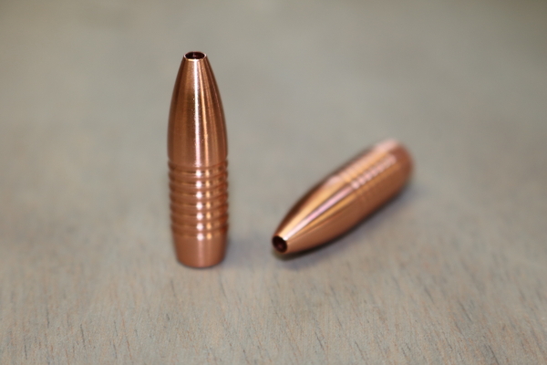

Does anyone have any suggestions how to increase the diameter of my Barnes .311 copper bullets? I have a bore that slugs at .3115" my initial ladder test and then test loads within the node are not promising. I think I need to increase the diameter of the bullet. Do you think I should wrap teflon tape around it or dip it in liquified PC paint and size or try to plate it?
Buy some Hornady 150 gr or 174 gr .312 diameter and see if they help your accuracy problem. Or knurled the diameter up in a lathe in a collet and a knurling tool. Or buy 8mm Barns copper bullets and turn them down to any diameter you desire. Without a lathe the larger diameter Hornady bullet would be the choice or change the barrel. Swaging up bullets take a lot of pressure plus special dies and cost a lot, and all copper bullets would be next to impossible for the average hobbyists, plating up would be an option.
A die can be bought that the smokeless muzzleloader guys use to size down bullets for sabotless shooting. I have one that's made for reducing the diameter of jacketed bullets. Hankins may be able to make one for the size desired. A friend has an SML land rider shooter and he sizes his bullets to .456 which leaves .002 on the diameter, .001 on the side of no contact with the grooves. If .3115 isn't working, there's something else going on, the load, the twist, the crown or other variable. A half a thousandth small shouldn't mean squat in a hunting rifle.. For measuring, the only thing calipers are good for in a reloading room is measuring the length of your cases, CTBO and CTOL. If one has a good set of eyes, case lengths could be measured with a six inch scale graduated in 100ths. OT, In my reloading room, I have calipers scattered around like cheater glasses, there's always one at hand to make quick use of.
The rifle is a T99 Arisaka and I want an accurate CA hunting round for it. Heavier Hornady bullets group well through it. Boy, those Hammer Bullets are expensive. I forced a lead slug through the barrel and measured it from groove to groove with a Harbor Freight micrometer as .3115". My initial test load was with R19 and I plan to retest using R15 next time. But, the bullet diameter is like the Speer 150-.311 bullets which didn't group well through this rifle either.

I have read of suggestions to take two new clean files and put a bullet flat on one and put the other on top and just move the file back and forth, parallel with the first. Won't take long to "knurl" the bullet. Or, you could powder coat the bullet to increase the diameter.
Knurling? I have heard people are using this process on muzzleloading bullets
